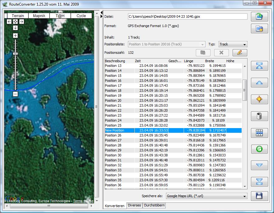

(11.05.2009, 20:55)RsH Wrote: I would also like to be able to copy a specific record/point/position and then inject, often in a specific location where I will edit the time for that position but keep the latitude and longitude, so that it is between the files I loaded and covers a photograph that was taken while on the trip but in between the GPS actually recording locations. After all, sometimes the signal is lost as I walk with the unit in my pocket and I need to add the physical location for a photo into the file so that it will geocode the photo correctly.
Hi Robert,
that is already possible: Have a look at the "New Position" between Position 25 and 26 - it's time is the average between the two other positions:
And if you double click into the time column, you can adjust the time to your needs.
