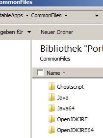

Posts: 7,675
I've just experimented and installed an "OpenJDK JRE" and then renamed the folder in "Common Files" from "OpenJDK JRE" to "Java" – and RouteConverterPortable works. So the lookup mechanism in the PortableApp Launcher seems to depend on that path name.
On an NTFS filesystem, one could create a symbolic link:
Quote:mklink Java "OpenJDK JRE"

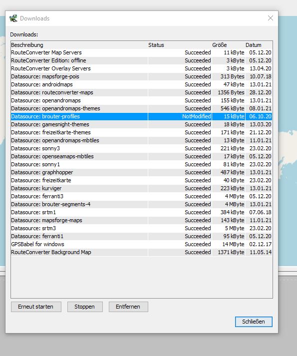

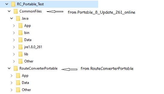

I tried the jPortabel way and after some trials I was able to get the RC Portable to work and, beside of a smal flaw (only the moped profile in BRouter, maybe thre are others too) it looks fine to me.
Test was made with a Win 10 2h20 virtual box 2 core 4096 MB mem, dir structure see screen.
Wilfried

Thank you for the report. Could you check which files exist in RouteConverterPortable\Data\brouter\profiles ?
Posts: 140
Threads: 4
Joined: Aug 2017
(12.01.2021, 16:18)routeconverter Wrote: Thank you for the report. Could you check which files exist in RouteConverterPortable\Data\brouter\profiles ?
Christian,
there are no files in this folder ( version 30.215, I think this is the most actual portable app one) and the BRouter planning option shows only "moped".
I checked the download display, it shows for brouter profiles a value of 15 kByte, also after a download restart and the folder was still empty.
I copied from an other RC installatation 3 profiles and I could select them the as usual.
Hope this helps!
Wilfried

Could you send me the RouteConverter.log file from your RouteConverterPortable deployment?

(13.01.2021, 08:30)routeconverter Wrote: Could you send me the RouteConverter.log file from your RouteConverterPortable deployment?
Hi Christian,
I'm not sure if 'send error report' with attachment did work so I resend it with 2 screens. All done with a 'fresh' data folder.
Wilfried
P_RouteConverter_log.txt (Size: 38.83 KB / Downloads: 685)
Posts: 7,675
The BRouter profiles where downloaded before the first rendering of routes. I've moved this to the startup phase so they're in the Options dialog even if no route has been rendered yet.
I haven't created a new RouteConverterPortable release with the changes yet. Please stay tuned.
