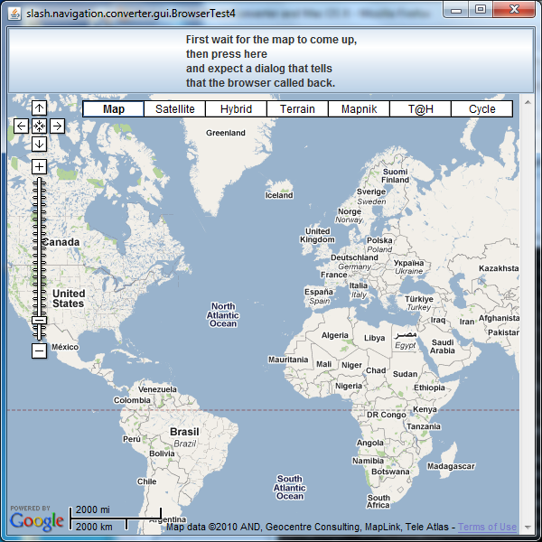

Good. The next try is to test if the test hits the same origin policy. Please try
If successfully started with 'java -jar BrowserTest4Windows64.jar', it should display a window like this:
And when you press the large button on the top, it should display this (this will fail on Mac OS and Linux, but should work on Windows):
Do you see that?
Both linux and Mac start successfully. However, the map is quite slow to display on linux.

Never mind. Your observation is funny, I thought the same origin policy would prevent this. Could you please clean the log file, download the latest prelease, start it on your Mac and Linux box, and put the log files into the forum? I'm interested in lines like
Quote:script 'checkCallbackListenerPort();'
Received callback: GET /callback-port/53479 HTTP/1.1
Received callback from browser after 50 milliseconds
Switched from callback to polling the browser

Fine, thank you. Both logs have the line
Quote:Oct 28, 2010 10:23:43 PM slash.navigation.converter.gui.mapview.BaseMapView$10 run
INFO: Switched from callback to polling the browser
and
Quote:Oct 28, 2010 10:21:54 PM slash.navigation.converter.gui.mapview.BaseMapView$10 run
So the intermediate result is: BrowserTest4 showed, that callbacks from the browser are possible. Although if've tried to model BrowserTest4 after RouteConverter there seem to be some differences. I'm going to create some debug versions of RouteConverter with lots of debug information to analyze, what is actually different.
