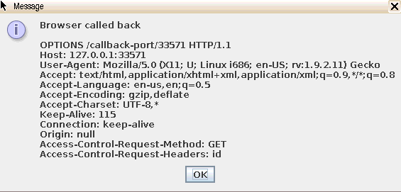

Good. The next try is to test if the test hits the same origin policy. Please try
If successfully started with 'java -jar BrowserTest4Windows64.jar', it should display a window like this:
And when you press the large button on the top, it should display this (this will fail on Mac OS and Linux, but should work on Windows):
Do you see that?
Both linux and Mac start successfully. However, the map is quite slow to display on linux.
When I press the button on my Mac I get:
When I press the button on Ubuntu 10.04 I get:
I have no windows machine around. Only at my work and I have a few days off.
(28.10.2010, 12:03)hvdwolf Wrote: I have no windows machine around. Only at my work and I have a few days off.
Never mind. Your observation is funny, I thought the same origin policy would prevent this. Could you please clean the log file, download the latest prelease, start it on your Mac and Linux box, and put the log files into the forum? I'm interested in lines like
