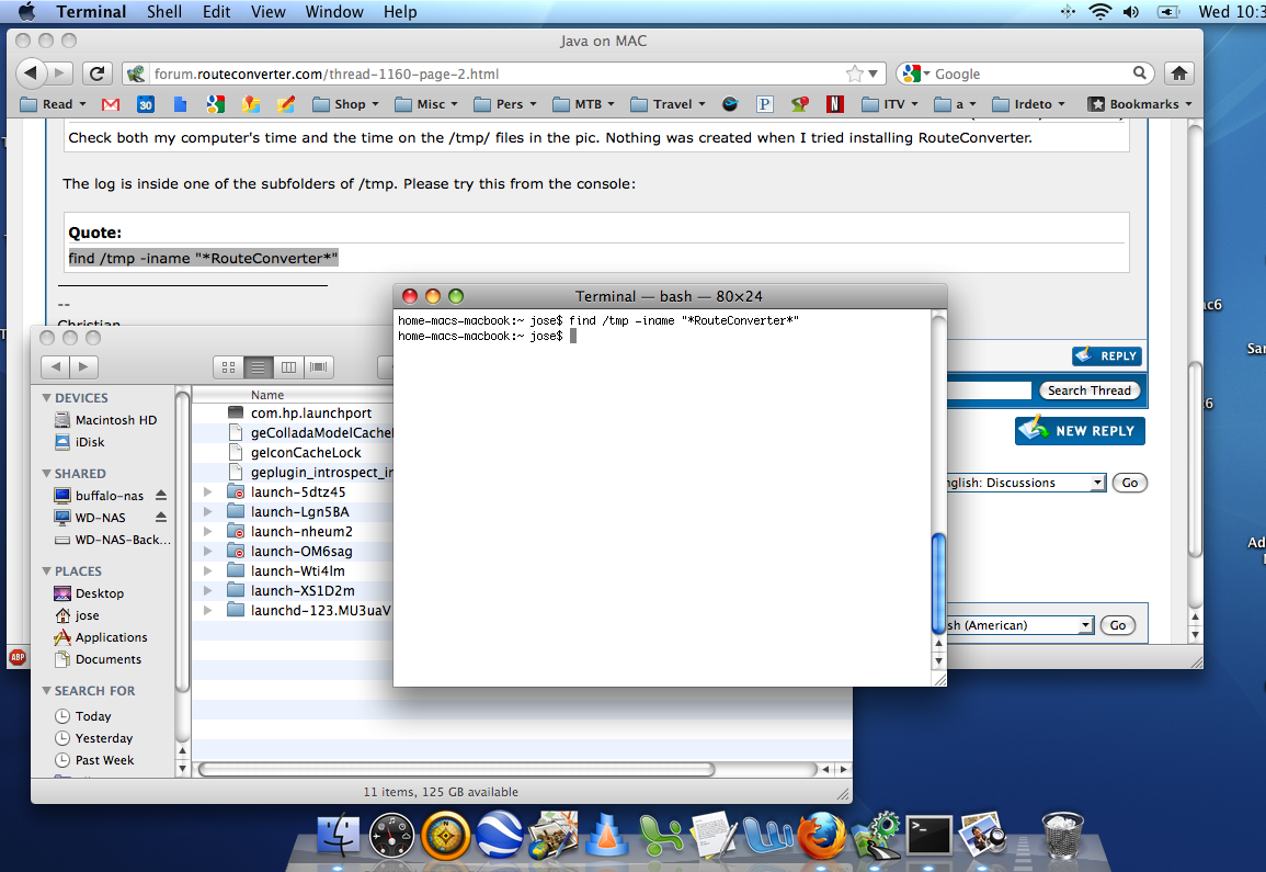

(29.11.2011, 17:45)Palom0 Wrote: Check both my computer's time and the time on the /tmp/ files in the pic. Nothing was created when I tried installing RouteConverter.
The log is inside one of the subfolders of /tmp. Please try this from the console:
Quote:find /tmp -iname "*RouteConverter*"
Nothing happens. See the pic

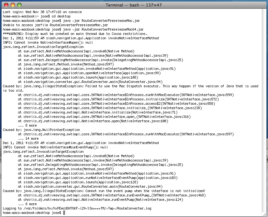

Last login: Thu Dec 1 04:18:33 on ttys000
home-macs-macbook:~ jose$ cd desktop
home-macs-macbook:desktop jose$ java -jar RouteConverterPrereleaseMac64.jar
***WARNING: Display must be created on main thread due to Cocoa restrictions.
Dec 1, 2011 4:27:41 AM slash.navigation.gui.Application invokeNativeInterfaceMethod
INFO: Cannot invoke NativeInterface#open(): null
java.lang.reflect.InvocationTargetException
at sun.reflect.NativeMethodAccessorImpl.invoke0(Native Method)
at sun.reflect.NativeMethodAccessorImpl.invoke(NativeMethodAccessorImpl.java:39)
at sun.reflect.DelegatingMethodAccessorImpl.invoke(DelegatingMethodAccessorImpl.java:25)
at java.lang.reflect.Method.invoke(Method.java:597)
at slash.navigation.gui.Application.invokeNativeInterfaceMethod(Application.java:91)
at slash.navigation.gui.Application.openNativeInterface(Application.java:99)
at slash.navigation.gui.Application.launch(Application.java:108)
at slash.navigation.converter.gui.RouteConverter.main(RouteConverter.java:94)
Caused by: java.lang.IllegalStateException: Failed to use the Mac Dispatch executor. This may happen if the version of Java that is used is too old.
at chrriis.dj.nativeswing.swtimpl.core.SWTNativeInterface$InProcess.runWithMacExecutor(SWTNativeInterface.java:599)
at chrriis.dj.nativeswing.swtimpl.core.SWTNativeInterface$InProcess.initialize(SWTNativeInterface.java:572)
at chrriis.dj.nativeswing.swtimpl.core.SWTNativeInterface$InProcess.access$2(SWTNativeInterface.java:558)
at chrriis.dj.nativeswing.swtimpl.core.SWTNativeInterface.initialize_(SWTNativeInterface.java:238)
at chrriis.dj.nativeswing.swtimpl.NativeInterface.initialize(NativeInterface.java:71)
at chrriis.dj.nativeswing.swtimpl.core.SWTNativeInterface.open_(SWTNativeInterface.java:316)
at chrriis.dj.nativeswing.swtimpl.NativeInterface.open(NativeInterface.java:100)
... 8 more
Caused by: java.lang.NullPointerException
at chrriis.dj.nativeswing.swtimpl.core.SWTNativeInterface$InProcess.runWithMacExecutor(SWTNativeInterface.java:597)
... 14 more
INFO: Cannot invoke NativeInterface#runEventPump(): null
at slash.navigation.gui.Application.runNativeInterfaceEventPump(Application.java:103)
at slash.navigation.gui.Application.launch(Application.java:128)
Caused by: java.lang.IllegalStateException: Cannot run the event pump when the interface is not initialized!
at chrriis.dj.nativeswing.swtimpl.core.SWTNativeInterface.runEventPump_(SWTNativeInterface.java:468)
at chrriis.dj.nativeswing.swtimpl.NativeInterface.runEventPump(NativeInterface.java:124)
... 8 more
Logging to /var/folders/hx/hxPEecUDH7GKF-l29-YJu++++TM/-Tmp-/RouteConverter.log
