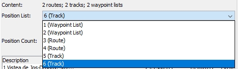

I created a *.gpx file containing six position lists:
Before saving: Two waypoint lists, two routes, two tracks

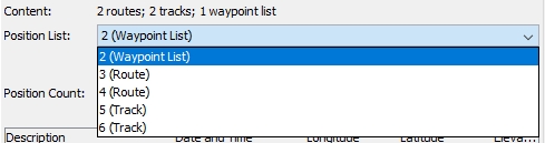

Then I stored everything as *.gpx file and re-loaded it again:
After re-loading: One waypoint list (that contains all waypoints of 1+2), two routes, two tracks
