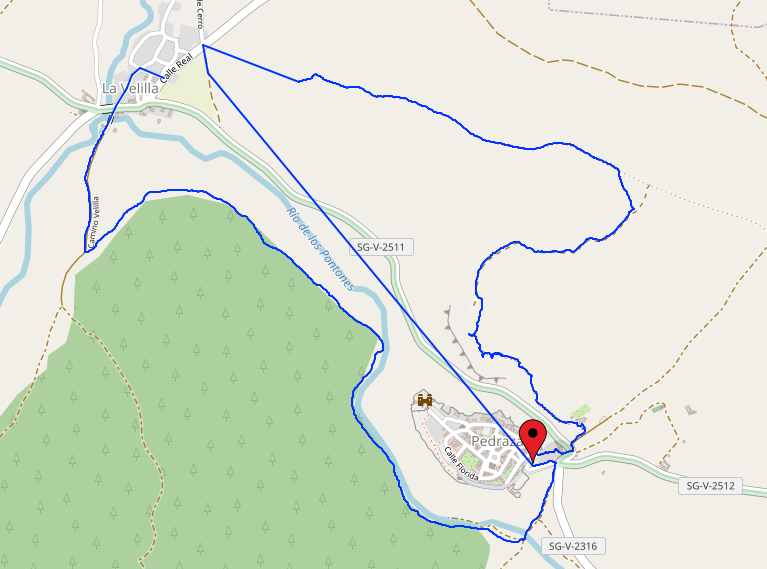

To anybody who can help: I am a total beginner with GPX and I don't even know what is the difference between a route and a track.  Nevertheless, I managed to load two GPX files (routes? tracks?) with the intention of creating a new route taking segments from both files.  I started by deleting everything I did not want which was quite easy (see attachment).  For simplicity, I shall use letters to denote points in the first route and numbers to denote points in the second route.  So, after my trimming I ended up with something like
a, b, c, d, e, f, 1, 2, 3, 4, 5, 6, 7
The problem I have is that the tool somehow linked point f with point 1 automatically.  I have been trying very hard to break this link in order to link point f with point 7 and later try to link point a with point 1 to create a circular route.  Could anyone explain to me how to achieve this using "instructions for dummies"?

(10.04.2022, 10:12)quiet-ranger Wrote: The problem I have is that the tool somehow linked point f with point 1 automatically.  I have been trying very hard to break this link in order to link point f with point 7 and later try to link point a with point 1 to create a circular route.
Breaking up the lines between positions in a track won't work. And since it's just a visualization, it doesn't matter.
What's important is the order of the positions in the position list since that's exactly the order that is written to the GPX file.
Linking point a to point 1 means you have to revert point a to f:
  • select point 1 and call Positionlist/Split to get the remainder out of the way for reversing
  • call Positionlist/Reverse completely on the remaining list
  • select point a and call Positionlist/Merge and select the remaining list

(10.04.2022, 10:12)quiet-ranger Wrote: I figured that out after opening the GPX file in a text editor.  With a bit of massaging and patience I eventually arrived at what I wanted.  Thank you for the clarification anyway.
