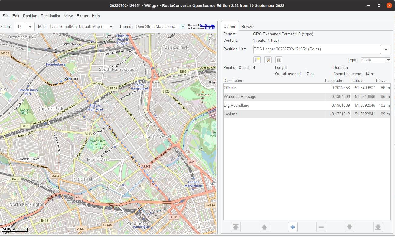

I've just downloaded and tried RouteConverter.  I like it that it's a single jar file with no external dependencies.  I created a test gpx file using GPS Logger on Android.  Opening this in RouteConverter, I get the four waypoints I created, but no trackpoints.  I don't necessarily need a list of every trackpoint, but I do want the route plotted on the map to show where I went.  It's just showing straight lines between each waypoint, and I can't find a setting that takes the actual route travelled into account.

Thanks Hans - attached.  Also a screenshot.

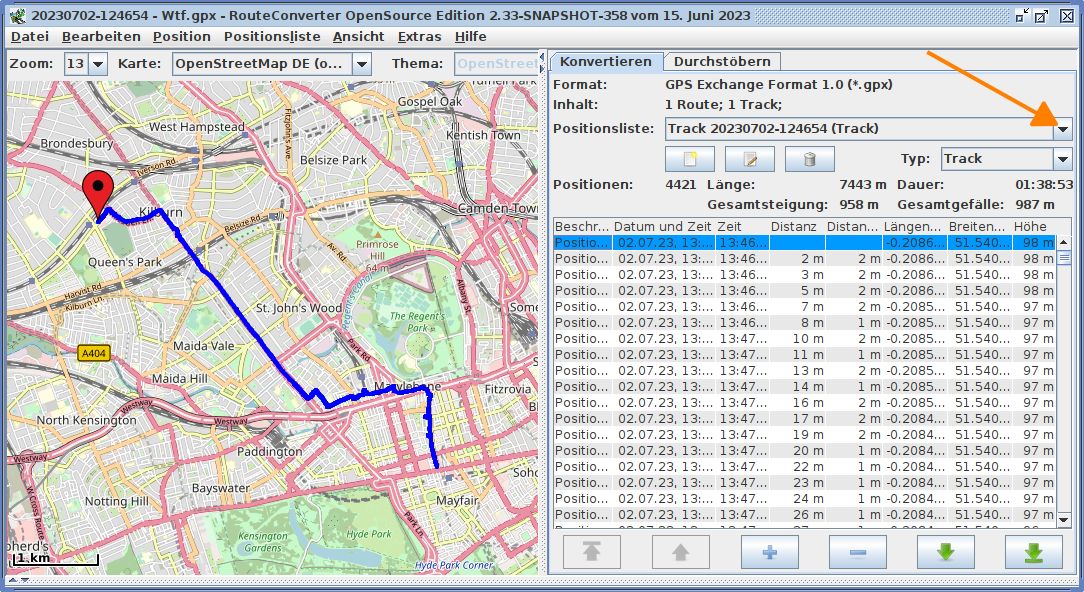

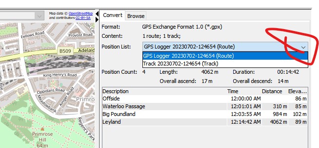

@grepnok Click the pulldown triangle on the right of "Position List". RouteConverter uses different views for viewpoints and tracks. Unfortunately, the viewpoints are shown first.
Wilfried :)

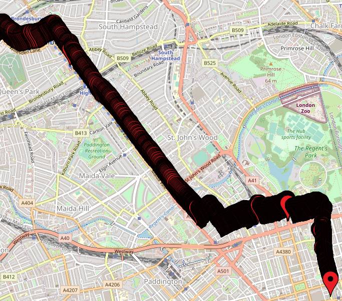

I can now list all 4421 trackpoint positions.  And if I click on any of them I get a marker.  If I select all I get 4421 markers - not very pretty.

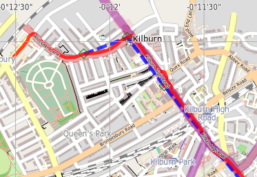

I was hoping for something like the red line in the Maperitive screenshot attached.
Maybe RouteConvert is not the right tool for this task.

(03.07.2023, 10:32)grepnok Wrote: If I select all I get 4421 markers - not very pretty.
Just for curiosity: Why did you select all? I normally select either a single track point or (rarely) just a part of the track.
