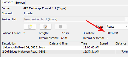

I am having an issue with the DURATION time. The Length / distance is correct, however the duration is was off.
These are the settings im using:
Google Maps
Nautic
Degrees
America (New York Eastern Time)
Any suggestions are appreciated!
Thanks!
TJ

OK, please let me know what other info is needed.
I'm using version 3.0 and Google Maps standard ( if switched to Open Street maps and others with the same results)
The issue is, the time, it takes to get from point A to point B under
(Duration) is incorrect. However the milage (
distance is correct)
My settings, under
OPTIONS tab,
GENERAL are:
Display measure in system of units :
STATUTE
Display Coordinates :
DEGREES
Display Times/Time zone :
New York Eastern standard
Time zone :
Local Time
I have provided a screen shot below. I hope this information helps. Please let me know if there are any other specifics you need to know.
Thank you!

Posts: 7,711
(10.12.2024, 17:34)TJ2224 Wrote: I have provided a screen shot below. I hope this information helps. Please let me know if there are any other specifics you need to know.
Yes, that helps. Actually, it's precisely what I would expect: the duration is the difference of the timestamp of the first and last position. Perfect!

Ok, so are you saying, based on the screen shot that this route should take 37 minutes and 11 seconds?

(12.12.2024, 19:15)TJ2224 Wrote: Ok, so are you saying, based on the screen shot that this route should take 37 minutes and 11 seconds?
Yes, that's exactly what your screenshot shows.
And you're not using Google,
the Google integration was removed from RouteConverter more than 6 years ago. Click
Extras -> Options -> Route planning, I'm pretty sure there's BRouter selected with one of the bicycle profiles.

Ah Ha! , Thats what I was looking for! BROUTER was selected, however moped was the profile! Thats why the route duration wasn't correct! I changed it to car and the time is now showing the correct duration for my route.
Thank you for your help, much appreciated!!!
