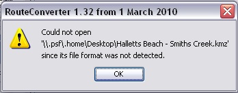

The attached .kmz file produces a 'format not detected' error dialogue in RouteConverter 1.32 running under Windows XP, as may be seen in the attached jpeg pic.

Could someone advise how I might be able to resolve what the issue may be.
The .kmz files opens OK in Google Earth; thus it appears to be a work
The file itself was generated by a Navionics app running on an iPhone3G.

(05.04.2010, 23:25)d101au Wrote: The attached .kmz file produces a 'format not detected' error dialogue in RouteConverter 1.32 running under Windows XP, as may be seen in the attached jpeg pic.
Hi d101au,
thank you for reporting a 2,5 year old bug which is affecting very rarely used constructs of KML-files. Please try the
current prerelease which works fine for me.

That worked fine for me as well.
Thanks

Just a note further to the above - I note when I view the converted output from the KML file I attached that there appears to be some sort of HTML artefact tacked on incorporated into the Waypoint name. Would it be correct for me to assume this artefact is likely to have been inserted by the iPhone app.

(08.04.2010, 08:24)d101au Wrote: Just a note further to the above - I note when I view the converted output from the KML file I attached that there appears to be some sort of HTML artefact tacked on incorporated into the Waypoint name. Would it be correct for me to assume this artefact is likely to have been inserted by the iPhone app.
Yes.
