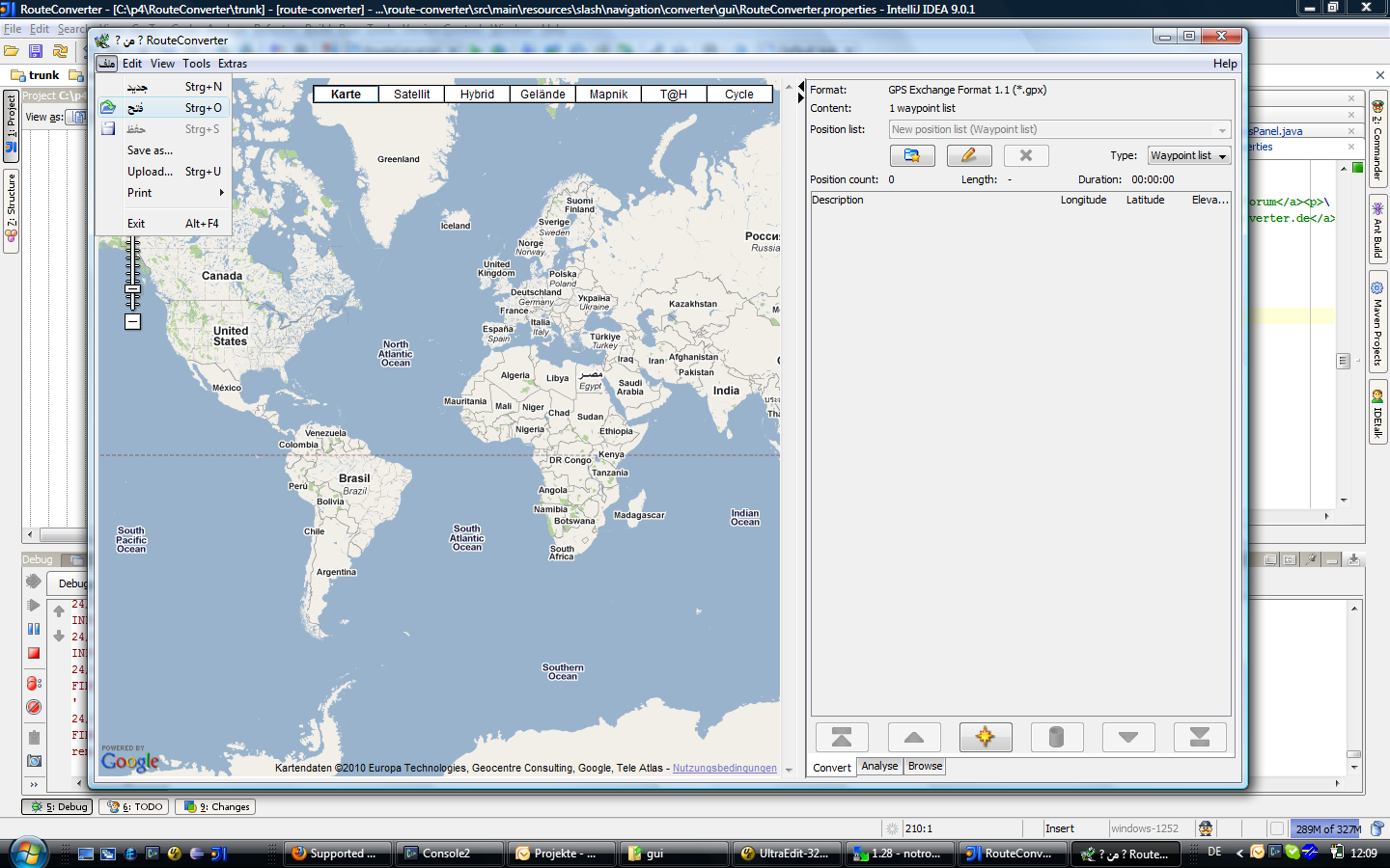

The latest prerelease I've just uploaded, allows to select Arabic (or what Google Translate returns) as a language below Extras/Options... RouteConverter then shows this file menu:
[Image: attachment.php?aid=461]
What you should do: Please double check the texts, mnemonics and keystrokes. Are they valid? If not, please send me a new RouteConverter_ar.properties.utf8 file, ok?
