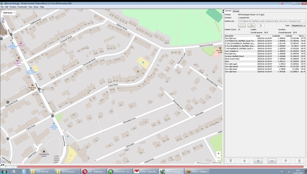

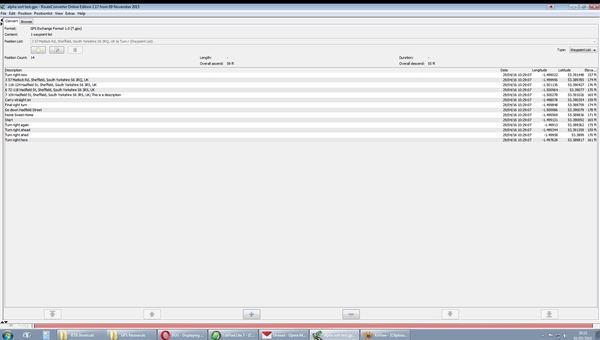

This is the sequence I went through
.jpg   Clipboard-3.jpg (Size: 136.19 KB / Downloads: 934)
.jpg   Clipboard-4.jpg (Size: 63.94 KB / Downloads: 855)
.jpg   Clipboard-6.jpg (Size: 134.3 KB / Downloads: 909)
Only this time it didn't go wrong! although the map in the 3rd picture is slightly out of position.
When it did go wrong the map was either missing or partially displayed in image 3.
