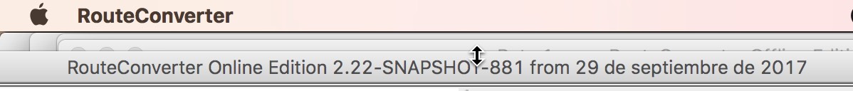

I upgraded to High Sierra (10.13) and now the menu bar is empty for 2.21.2 Online (but keyboard shorcuts works), so then i downloaded 2.22-SNAPSHOT-881 and then, in Online version, the same problem, but the Offline shows them!
I've tried this in 2 different Macs. 2.21.2 Online worked in Sierra (10.12) without problem

Attached an small capture of this.

When launching RouteConverterMac.app the window has no menu bars as expected. However the Mac manu bar (the one on the top of the sreen) only shows a single entry named RouteConverter and nothing happends when clicked (no dropdown menu list)
