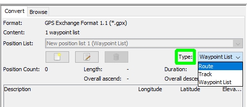

Just getting started and need some help. I use a tablet with win10. I downloaded the program, and wanted to create a route. I tried the right click and choose...... but no insert. I have a choice of select, new or delete. Select doesn't do anything visually. New gives me a waypoint in my list. But as I add waypoints, I don't get the blue line.
I tried the control and left click but same as right click with new.
Help please.

Hi and welcome here...
This should answer your question:
This setting defines
- how a waypoint list is displayed on the map
- the type of a waypoint list when it is saved (some file formats like *.gpx that can contain different types of waypoint lists)
I for myself like to plan 'rough' routes by setting the major points in type 'track'.
Always keep in mind that no 'route' as-displayed is transferred to a receiving device:
Only the waypoint list is transferred and the receiving device creates a route based on its own settings.

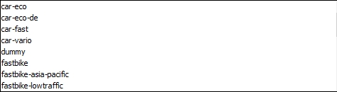

Also: when I go to Tab extras, options, routing, plan routes for, just shows "Moped", no other options. The help section specifically shows I should be able to choose "driving". I'm not sure this has anything to do with my questions, just an observation when going thru to set the desired parameters.

Regarding the routing options:
You should see BRouter routing options like...
...but no 'driving' there. Please give me the link to the Help page with 'driving'. And check it with the prerelease as well.
